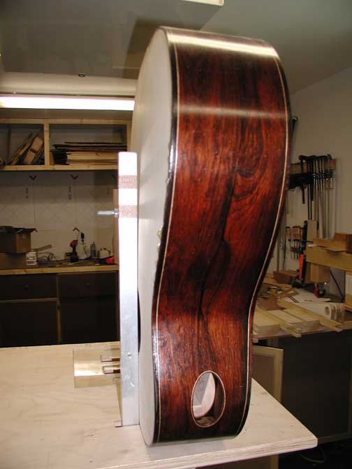

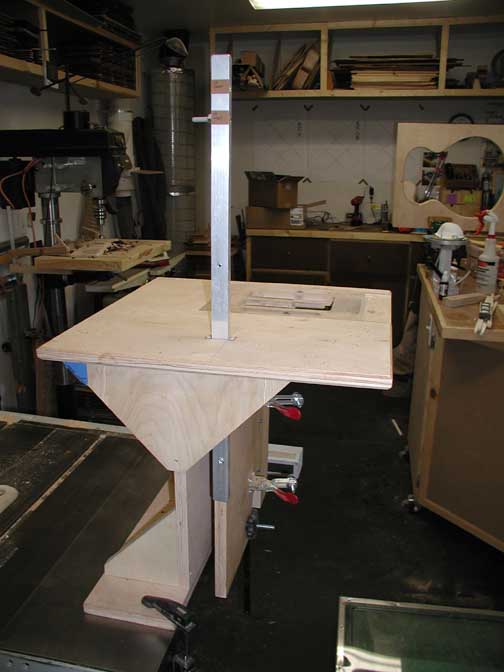

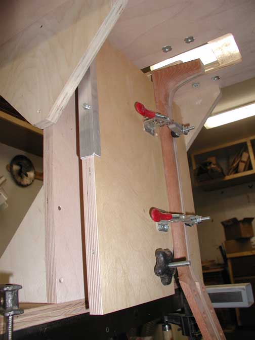

The body of the guitar is mounted to the jig...here are some pics that might help.
Craig

Thanks Craig, those where the pics that I lost in the computer crash.
Greg, the body does't get fastened to the jig at all. This is for the tennon only. You use the body as in the second pic to get the angle of the side to top at the neck joint. With the side sitting flat on the top of the jig (as shown) the whole plate that holds the neck can swing. When the al bar sits perfectly flat on the top and the bolt is just touching at the bridge location, that's your perfect angle. Tighten it down and have at the tennon.
The bolt: here's how I figure it. If I want a 3/8" bridge I want the fretboard to be in the same plane as it is. So if the fretboard is .25, I would subtract that from the thickness of the bridge leaving me .125. That's how far I want the bolt sticking out toward the body. It's perfect when the side of the guitar is flat on the top of the jig, the aluminum bar is flat on the fingerboard extension and the bolt is just touching at the bridge location.
